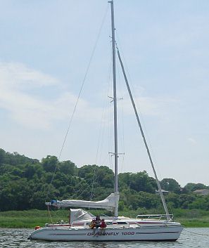

I also have the taller rig with a square top sail. My mast has the triple diamond wires on the mast, plus an additional "jumper" on the front section of the mast.
The manufacture I believe is Selden.
Please click on the photo to see it enlarged!

Sorry I didn't have more pictures of the rig, just never take any pictures of the top of the mast. The one I sent you is about six years old.
