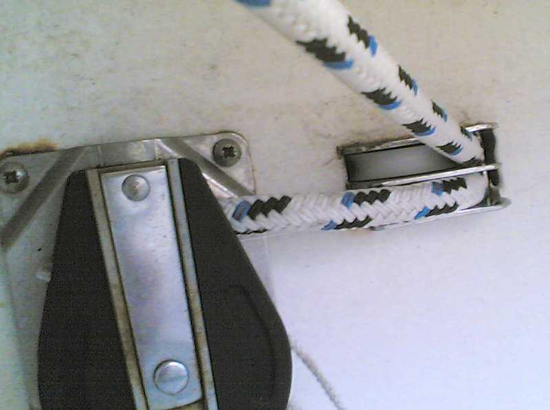

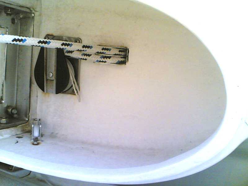

Any ideas how to remove the sheave box located at the fixed end (on hull) of right aka? These ropes controls amas in / out function (white ropes with black/blue dots).
I could not find a way to reach this installation from inside and there are no screws outside.
How about left side, do I need to remove the fridge to get there?
Please click on any of the photos to see them enlarged!
