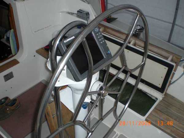

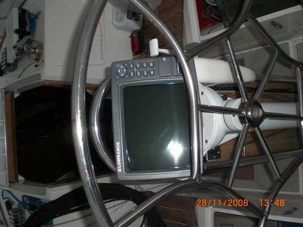

I did not like the size of the original steering wheel. It was impossible to reach good ergonomic position with it when steering or simply my hand was too short .
I decided to cut off the center part of the original wheel, and recycle it to a new one.
The design come from need to see GPS chart plotter. It took about 10 hours and 200 euros to build it.
I am still wondering will I cover the wheel with Lorica synthetic leather or with some kind on polyurethane coating.
Attached you'll find a couple of photos of the new wheel before it has been finished and polished and also a drawing how to build it if interested.

It is perfect. Steering in high speeds is much easier and you don't need to work so hard any more. Ergonomics is much better when sitting between the winches as I always do.Baboonty wrote:Mika, I also would like to have a bigger wheel but I expect to increase the actual diameter by only 20 cms. You have now a 100 cms wheel, do you feel happy with it?
With big wheel it is also possible to steer when standing on the both seats behind the wheel and looking ahead over the cockpit tent. This helps when you're doing harbor manoeuvres.
This has been a great improvement. I recommend it for all DF1000.

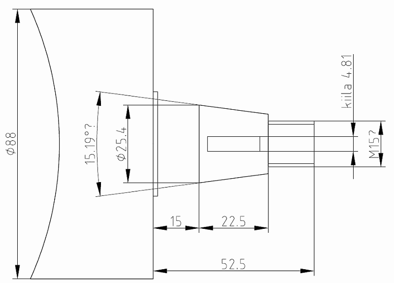

I do have a project going on to make a carbon steering wheel. Mould and stainless steel centre are ready made at the moment. Are you interested to get one after mine is ready made? It should weight less than 2kg which means low inertia. This makes steering light both for human and autopilot.Baboonty wrote: I found on Ebay a 81 cms Lewmar Commodore wheel but I'm wondering if it will fit on the current steering axis. Do you have any idea, I'm quite far from my boat?
Attached you'll find my measurements of the Edson pedestal axis. I could not find any exact dimensions for the cone from any pedestal or steering wheel manufacturers so the cone angle might be slightly wrong.
