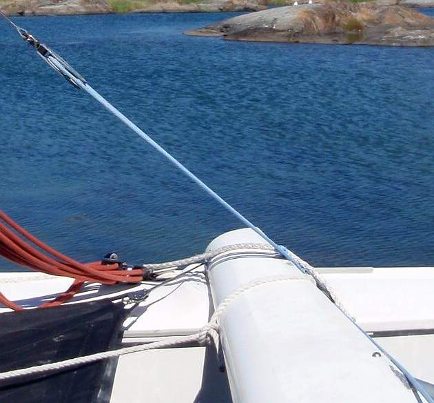

Does your backstay (or shroud) ropes wear on the beams? I have noticed that all bends of the rope going up and down between the blocks are in contact with the beam. Have been thinking on lifting the lower block so the rope goes free. Has anyone done anything about this? Any ideas? / Christian

Hello Christian, your backstay does not look right, it shouldn't be touching the beam at all. On my DF the backstays are on the OUTBOARD side of the floats, not the inside, and attached to the padeye U bolt about 200 mm to the rear of the beams.
I can post a foto of my backstay set up if that helps.

Christian - Changing the location of specially reinforced attachments is not a small job. Unless your boat was reconfigured by a prior owner after manufacture, I'd consider that choice only if there were no others.
I think the best solution is to shorten the (long section) of the shroud above the quick link, and lengthen the section below by the same amount. That will change the angle of the multi-part adjustments and allow them to clear the beam edge.
If your rigging does not need replacement you will need onlycut the upper section and replace only the lower attachment fitting (you could use Norseman or Sta-Lok mechanical fittings and do it yourself) and you will also need to replace the short lower section of wire with a longer one. For the new section you might want to consider using Dyneema single-braid instead of wire -- it's a simple splice and you could save weight and money by splicing thimbles at each end and using a D-shackle at the lower end attachment.

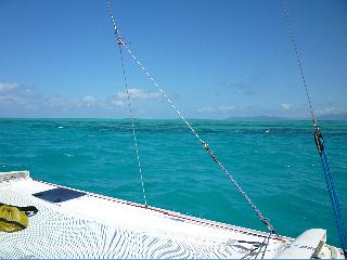

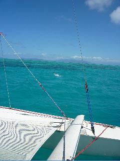

I have sent a photo to Bo to add to this, as you can see, both side stays are in front of the beam and attached on the out side of the aka. My rig was replaced by the previous owner and he has added a dedicated backstay (the blue line) which allows for mast bend adjustment. Hope this is useful, and agree with Larry that changing the shroud lengths is the best way to go, also changing from wire to dyneema or spectra is a very good idea.
cheers and enjoy your winter,
( as you can see in the photos, taken on the Great Barrier Reef, we have nice warm weather. )
