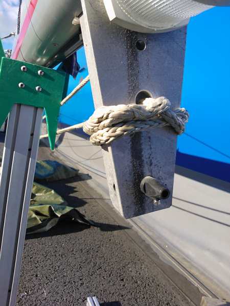

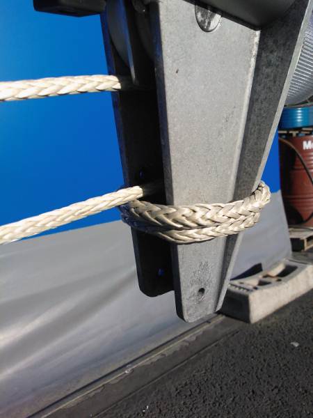

The Karver block fits into the mast top fitting so there is more room for bigger sail, please see attached photo. You need to use lashings to control the rope as seen on page 21 of 36 ( http://www.karver-systems.com/en/downlo ... rtdown/19/ )

Rope shackle is too long and slow to operate on top square main when you need to release the top quickly to get it down.
My setup is a Wichard fixed eye quick shackle and dyneema lashing.
