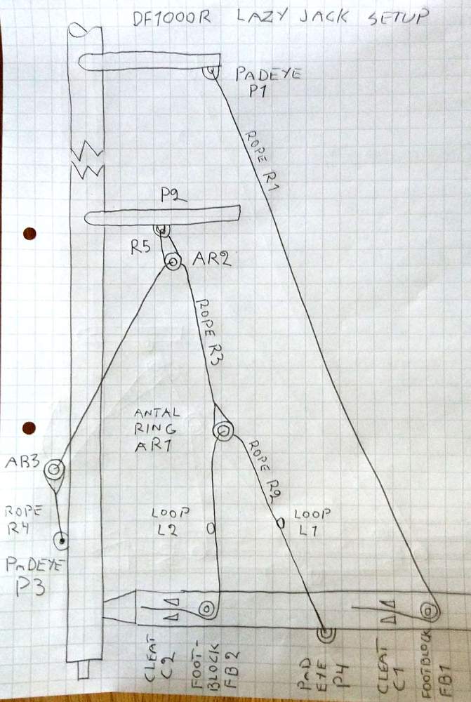

About Lazy Jack setup, see attached schematic (photo):
1- My DF1000R is equipped with a rotating mast and quite a big square top main sail. This setup does not work with a fixed mast because the padeyes P1 and P2 are too far from the center of the mast.
2- There are two ropes, R1Left and R1Right, coming down from the outer tips (P1L and P1R) of upper spreaders to the boom. The boom is equipped with small footblocs (FB1L and FB1R) and cleats (C1R and C1L) to adjust the height position of the boom. Footblocs and cleats has been added to the boom.
3- LazyBag is operated by rope system R2-R3-R4. This system lifts the LazyBag up for taking the main sail down. Operated manually by pulling the ring AR3 underneath the padeye P3 after the LazyBag is attched to the rope loops L1 and L2 on both sides. When sailing the LazyBag is rolled around it's battens next to the boom. Without this lifting system loops L1 and L2 are located too high to reach.
4- Lifting rope R3 routing: AR1L - AR2L - AR3 - AR2R - AR1R
5- Guiding rope R2 routing: FixedPadEyeOppsiteFB2 - AR1R - P4 - AR1L - FB2 - C2.
6- Rope R4 prevents the AR3 to get too hight to reach.
This might look very complicated compared to the original system but this works very well. Easy and quick to operate when sailing even single handed.

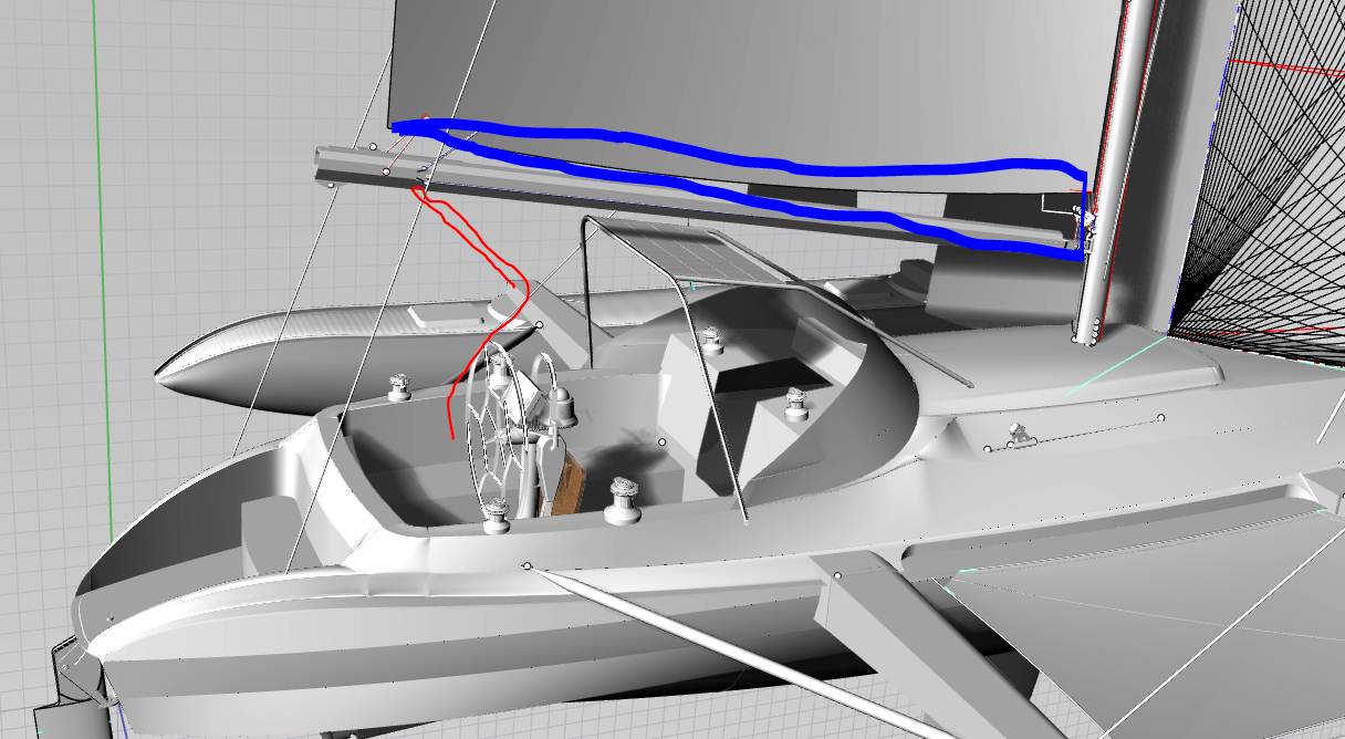

I have misunderstood you. I was talking about boom outhauling arrangement, ie. how to move the boom left-right direction. :oops: See red rope in attached PDF.

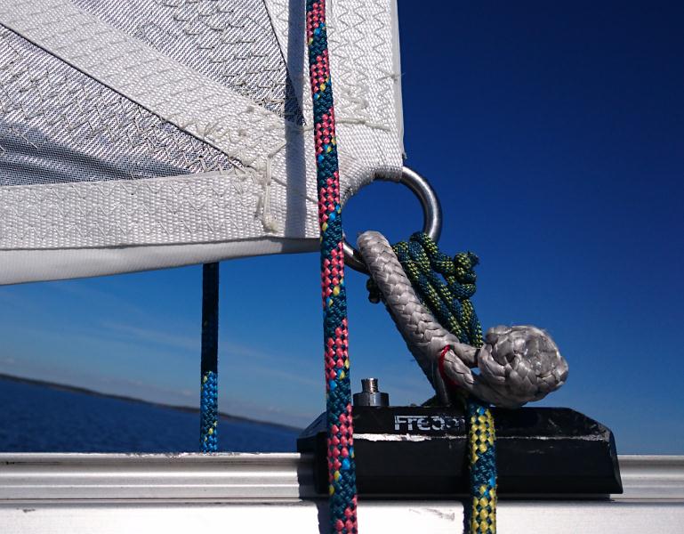

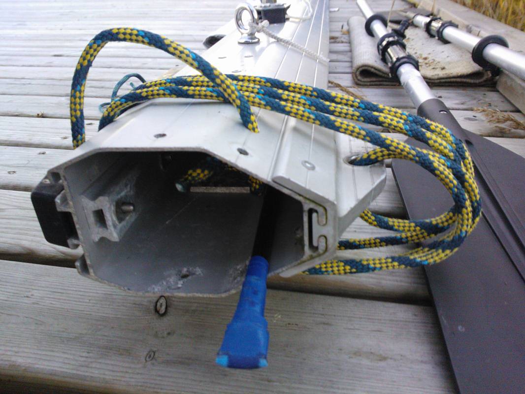

Anyhow I do not have any main sail outhauling system. I have removed the boom aft end fitting completely because it is useless. I have replaced it with fixed Dyneema lashings, see attached photo. Basictly you do not need this adjustment on a trimaran like DF1000 because the triangle MainTack - MainClew - BoomPivotPoint, see blue triange in attached PDF. This arrangement tightens automatically the foot of the main sail when the main sheet is tightened during tacking.

For the lazyjack look higher up to Mika's reply, I've added it there.
