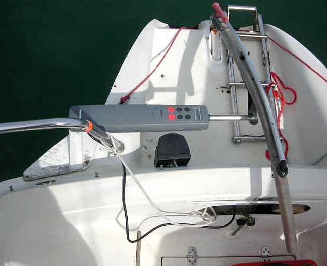

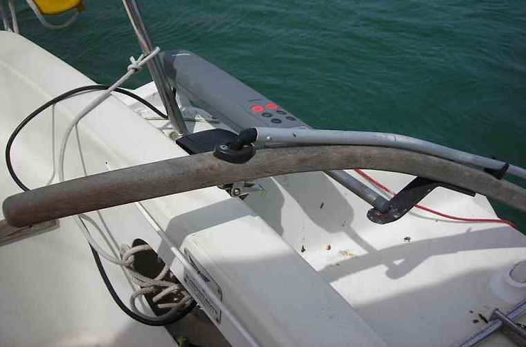

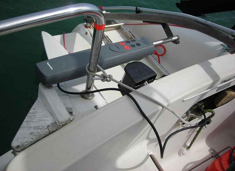

Following previous questions please find some pictures of the installation of my Autohelm 2000+. I have selected the 2000 because faster than the 1000. Electricity comes only from a 45W solar panel. That is just enough for daily sommer cruising with some late night arrival. Philippe Damour

thanks so much for this useful post. I'd like to fit an ST2000, can you plse tell me what extras you had to buy. Eg. is tiller bracket the 1, 2 or 3 inch please. Any other plugs etc. required which didn't come with the unit (which I've ordered but not yet received).
I forgot to ask, is there any reason why you chose to mount the ST2000 on the starboard side (where it obscures nav light) rather than on port side (I'm guessing the ST200 can deal with mounting on both sides?)?
When I had one of these, i remember that it came set up from the manufacturer to be mounted on the starboard side. You had to enter some code to reverse the mounting to port side.

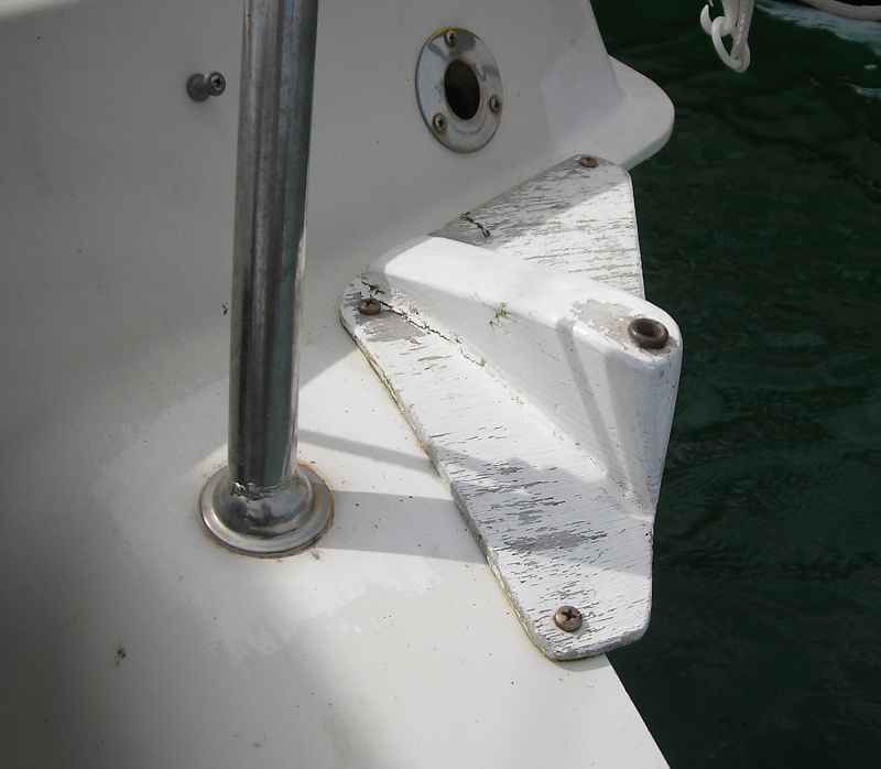

Quoring used to make a bracket the mounted to the 800's to mount these.
Check with Jen's if he still has any. It was a real nice bracket.
Ted
Thanks, I now understand quorning do a stainless bracket for 188 euros + vat and post, think I'm going to go with a DIY wooden one. Am afraid I'm unable to upload the photo I got of the bracket.

Who has pictures of the stainless steel bracket for the autopilot as mentioned by Humphrey ? Any other suggestions to fit the autopilot on a DF 800 ? Thanks a lot in advance.
Kind regards from Austria
I was just informed by Quorning that the former "niro steel bracket" isn't available any more. Therefore a picture (sent to adshanta (et) yahoo.de) would be very well appreciated
