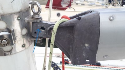

Does anyone know the maker of the gooseneck fitting on the boom? Our 920 Extreme 2004.
Ours is very worn and we need to replace it. Can anyone suggest a supplier please.-

Re: Boom gooseneck parts need replacing
Thank you for your reply. Our rigger has supplied a new part which is modified from a Z spars part and looks exactly as our original toggle.
