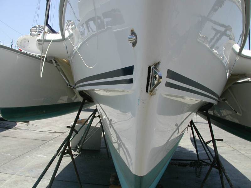

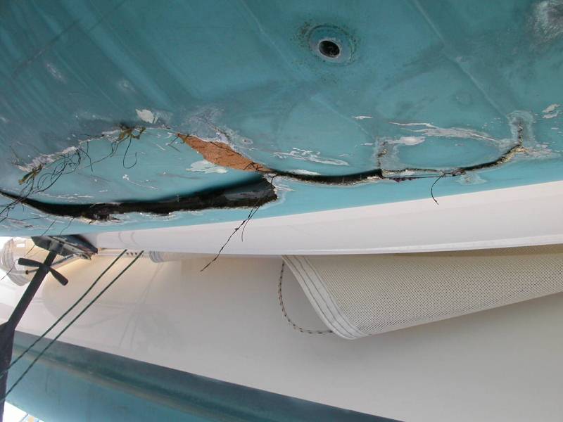

I found 3 pics before repair
I found three of the hull damage pics of the boat in question.
Not sure if I should post them or what.
- Posts: 440
Re: I found 3 pics before repair
I think we are all curious.Steve B. wrote:I found three of the hull damage pics of the boat in question.
Hull damage pics
I'll post them if Bo agrees.

After a number of questions he said boat was damaged /repaired 'hull scratched ... with cracks ....', on Catalina Island ....'which has pebbles' and this might back up pics kindly supplied above with no scratching but severe compressional rupturing all along main 2/3 (?) of (Port) hull beneath waterline - Not quite what the Ebay.com advert discloses IMO!
Boat is afloat and was apparently sailed last Sunday, agent not sure of engine condition with the (new) 30hp engine. In other words it needs a thorough engineers and marine surveyors report.
However I was sent:
Surveyors report dated 5/9/2010 so after the event/ repair. This is available from broker or try http://www.schulzsurveyors.com Vessel is listed by them as CF5573TB
The surveyors report doesn’t look complete, could find no osmosis / moisture meter readings taken at all or reference to previous damage at all.... and not easy if boat afloat! .... Hull : '.......... appears sound' with LOTS of normal surveyor caveats!
There was also surveyors disapproval at '..outrigger diagonals are not laid properly and bent too sharp.....' and mention of engine mechanic required to 'check alignment ' ( Done by Marine Aqua services)
Before proceeding any further one might want to view:
1. Damage / repair bill receipts
2. GRP repairer/contact details and as important their accreditations to international standard.
Consider these points important as any surveyor, owner or re-sales agent should, regarding a boat that has suffered water ingress, and this clearly has.
The inner Divinicell foam has probably been compromised even at bow, (while towing?), and significantly the nature of the compressional fracturing caused along the main 2/3rd to the boats (Port) bottom hull side is akin to a soft boiled egg being cracked,so one might expect repair to be absolutely competent and structurally compliant.
Impending water ingress would have possibly affected entire inner foam, this can intake and retain salt water but I think not like sponge... and that would not be good.
'Hi-Tech yacht builders always seal the foam, usually with a mix of Q-cell and aerosil mixed with what ever resin system was used'. Believe that water adsorption is up to first closed foam holes or 2%.
Q. If not fully dried out what affect might this have over the years?
Any purchaser would want to know what measures were put in place regarding:
A) Was boat flushed with fresh water and thoroughly dried out before repair and moisture check ascertained prior to closure?
However I was sent:
B) Removal and replacement with same marine grade Divinicell foam and associated bonding to foam, stringers etc to an international approved standard of workmanship for re-insurance purposes.
C) Make good same GRP layers , cover and fair and gelcoat etc for re-insurance purposes

Feathercraft, I don't disagree with your cautions but there are a points where I have questions:
The image posted above on the right is titled portcloseup.jpg so your comment about starboard damage might be off base. It's difficult to determine extent of damage and locations on the hull, due to lack of visual clues for perspective. A zoomed-out picture port and starboard would be helpful but we don't have the benefit of those.
The area of the damaged bow eye might be solid FRP. I think it was Steve who noted above that this boat used to have a bow platform, and if so it too might have been damaged from towing. It would have had a rigid bobstay attached to the bow eye point.
As to your comment about stringers, you won't find many in a Dragonfly. The engine beds have stringers, but other than that Dragonfly boats rely on structural bulkheads, shape, and stiff cored composite panels for integrity. The areas along about 1/3 to 1/2 meter of centerline are solid FRP (to allow the boats to dry out), the bows, rudder post areas, and propeller skeg, centerboard area and waterstay attachment areas are also solid FRP.
Repair of a thin-skinned foam sandwich hull is tricky but it can be done by a skilled fiberglass person. I don't know if it's possible to do properly without access to both sides of the panels being repaired, but in this case it appears from the photos on eBay that the original liner is still intact. Ideally, if the person who did the repairs documented them (and was available for questions) it would be very helpful to a perspective buyer/surveyor. No doubt there might have been decisions made in repair that involved practical compromises.

Hi Larry
Many thanks should have looked ref Port/stbd pics and thank you for explaining what lies inside here!
There may well be as you say no foam behind this bow point.
Agree difficult to ascertain nature of repair but reasonably sure that this has been sailed recently and surveyors report assumes market value on 5/9/09 at $134K subject to 'all recommendations completed'.
One might also assume that the repair was carried out to a professional standard by qualified yard and they would be very useful point of contact.

Other comments from memory
I don't have any more pictures (although I used to). but as I remember there were none of the starboard side.
I think it's safe to assume the damage was limited to the port side of the main hull.
The other photos were wide shots, with bedding hanging out of the cracks in an attempt to slow ingress of water.
The settee cushions look new, and I faintly remember the originals were stuffed into the holes as well.
Both vertical sides of the settee bases look like they have been painted (to cover water staining?)
Ours are faced with teak.
